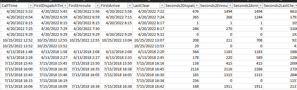

I have been tasked with creating a dashboard for our calls for service and have no experience with Arcade.  I would like to calculate our average response times from when our car gets the dispatch (FirstDispatchTime) until they arrive (FirstArrive), eliminating null entries in the calculation.  A portion of the data export is below:
All of the 'Seconds2' columns are internally calculated using the 'CallTime' column so that does not really reflect our departments response time as we have no control over how long dispatch holds the call.
Ideally, I would like the displayed result shown as 'mm:ss' on the dashboard indicator.
Any script suggestion would be greatly appreciated!
