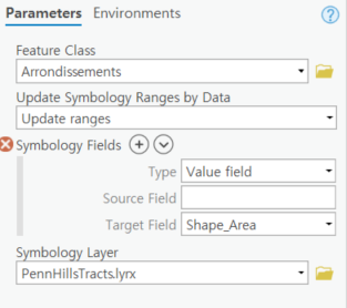

I put the tool in my model builder and set required fields of the tool parameters by right-clicking the tool, creating variables, and assigning parameters. After hitting the save, I opened the model to run as a model (not inside the model builder). Here my problem goes.
I was able to set the input layer, symbology layer, and even update symbology ranges. However, the source field from the Symbology Fields did not have the drop-down menus for selecting the field. Anyone knows how to solve this?

Luckily, I found a tool make feature layer which converts the feature class to feature layer.
The tool, Apply Symbology From Feature Layer, required the input as the feature layer not the feature class when being used in the model builder.
