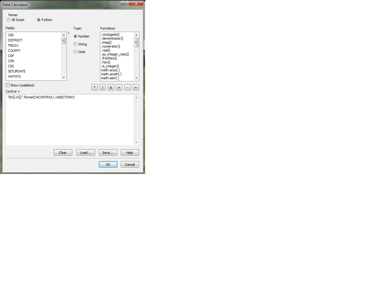

Typing it exactly like you have it. I am getting a ValueError : zero length field name in format. I have those field names so I'm not sure why it doesn't like it.
DanPatterson_Retired
MVP Emeritus

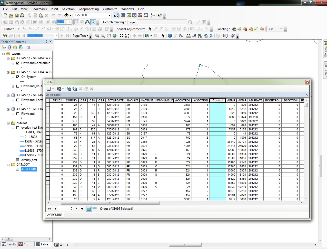

you added a text field...correct...and are doing the calculation there.  a screen grab of your table with the field calculator would go a long way to shortening this thread
MichelleCouden1
Deactivated User
Screen1.jpgScreen2.jpgYes! I just looked to double check. I'll attach 2 screen shots. One of the table one of the field calculator. Let me know if you need anything else. I am going to keep trying to figure it out.
