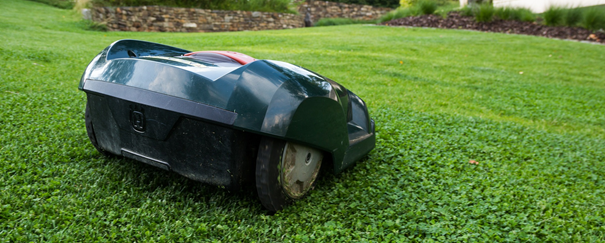

For our example, an off-the-shelf robotic lawn mower was used and extended with location awareness. This information is linked to the ArcGIS technology. The result: an even smarter robotic lawn mower that cannot only mow the lawn but is also informed about relevant severe weather alerts and in which cases it might be better to return to the charging station. At the same time, it uses its sensor data to "warn" other devices in close proximity.
The basis for these capabilities was established in a term project at the Bochum university. Students and faculty staff worked together extending the functionality of the robot: Communication with the device is possible via REST, it can determine its location with a GPS signal, and it can be controlled remotely. For the detection of the current position, a USB GPS module is used. Temperature and humidity sensors complement the existing sensor system. Both sensors are connected to a Raspberry Pi and mounted on the robot.
The entire actuating system was deployed using Python scripts. The current sensor data are being read in specified intervals and published via MQTT (Message Queue Telemetry Transport), an open and light-weight messaging protocol for Machine-to-Machine (M2M) communication. A MQTT broker is being used for this particular purpose. Eclipse Paho allows for the integration of a MQTT client deployment in the Python scripts for publishing and receiving sensor data.
The most difficult part of the implementation is the robotic lawn mower's control system. Initially, the mower did not provide for any open communication interface. But a resourceful developer in the north of Germany devised an extension module ("Robonect H30x") in his free time that allows for the transmission of HTTP control commands to the robot.
For the mower to determine if it is located in an area with severe weather alerts, information from ArcGIS GeoEvent Extension for Server is integrated.  As an ArcGIS Enterprise extension, this component allows for automated real-time data processing. The GeoEvent Server does not provide any "out of the box" MQTT connectors, though. A project to deliver this was set up by Esri on GitHub and rendered possible an upgrade with this important feature.
Severe weather alerts are provided as GeoFences, synchronizing with an ArcGIS Feature Service.
Real-time sensor data are collected via a GeoEvent Service. So-called GeoEvents are generated automatically from the MQTT JSON message to check if the robotic mower is located in an area with severe weather alerts. If this is the case, the robot will receive a "Go Home" command via MQTT to return to the charging station.
For persistence the sensor data are transferred to a feature service and, in addition, are used by a stream service for real-time visualization.
Visualization and control of the demo run on a JavaScript Dashboard that was configured specifically for this purpose.
