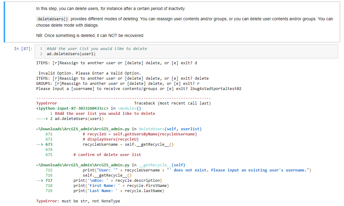

Deleting Named User fails if a user has one or more licenses assigned, to ensure deleting works without any problem, programmers are reminded to always revoke licenses before deleting users. Exceptions should always be handled correctly, exceptions invisible to the user may also prevent scripts from working correctly. Sometimes missing attributes like biography-description-texts can lead to malfunctioning of scripts, it is always suggested to use if-else-queries to prevent accessing attributes, which are missing.
Missing biography-description-text causes delete to fail
Deleting Named User from ArcGIS  can be safely performed if the user:
  • Has no licenses assigned
  • Missing properties (e.g. biography-description-text) for users are properly handled
  • Unimportant exceptions are properly handled
