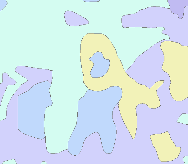

Here is a screenshot of the lines and polygons, the lines are exactly the same as the borders to the polygons:

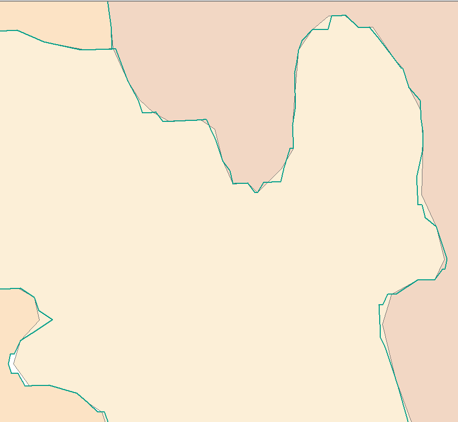

After appending the geometry into SDE here is what it turns into what looks similar but has changes like this:
The lines no longer match the boundaries and the boundaries have been generalized.
