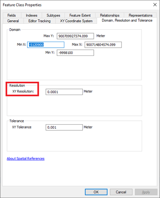

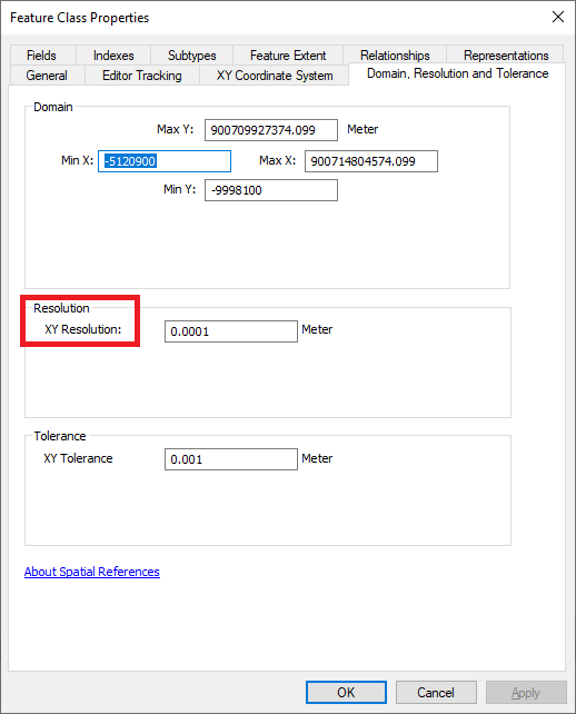

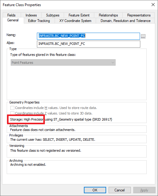

I've created a new point FC from scratch using Catalog (using all the default settings).
The General tab mentions "Storage: High Precision":
Whereas the Domain, Resolution and Tolerance tab mentions "XY Resolution":
What's the difference between "Precision" and "XY Resolution".
Thanks.

Note that "precision" refers to both the vertex equivalence comparison tolerance AND the spatial reference coordinate storage depth (though at this point, *all* spatial references are HIGH precision).
