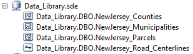

I have an SDE Geodatabase created on our Arc Enterprise Server. Is there any way to shorten these names that are created when importing or creating a feature layer within the geodatabase? For example, the first layer is "Data_Library.DBO.NewJersey_Counties" is there any way to shorten the name to just NewJersey_Counties?

What you see in Arccatalog or in screen capture you provided, it is fully qualified name. It shows, the feature class "NewJersey_Counties" owned by "DBO" and created in geodataabse named  "Data_Library". This is by design.
