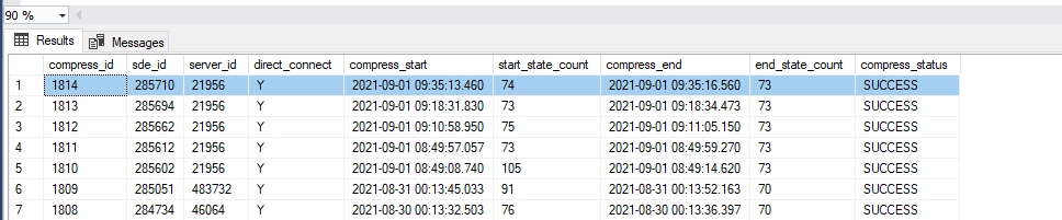

Hi, The Records are always stays in Delta tables and they are not removed from Delta tables after Compress.
We have a feature dataset with topology enabled with certain rules on it. Whenever we enabled topology on feature dataset, The feature dataset should be enabled as "Registered as versioned". The users are editing on SDE.Default version directly without creating any child version on it. Whenever we edit feature classes in that feature dataset, it created records in 'A' Table. I am doing daily compress or full compress. The records stays in 'A' Tables and not removed from delta tables. I unregistered all Replicas and tried. the issue is still the same. What I need to do  for Full compress to remove all Orphaned records? I am using ArcGIS pro 2.8

[SDE_compress_log]
[SDE_versions]

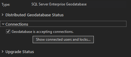

I disconnected all users from geodatabase and uncheck the option. and did compress. still data exists in  Delta tables
