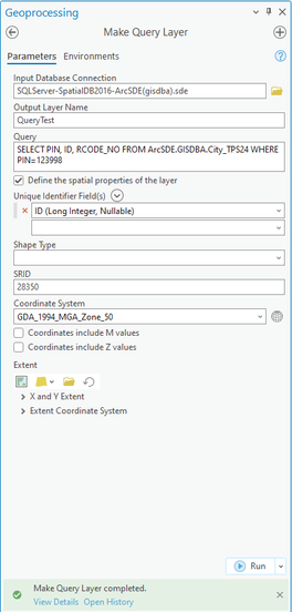

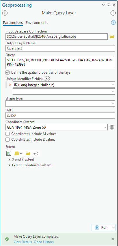

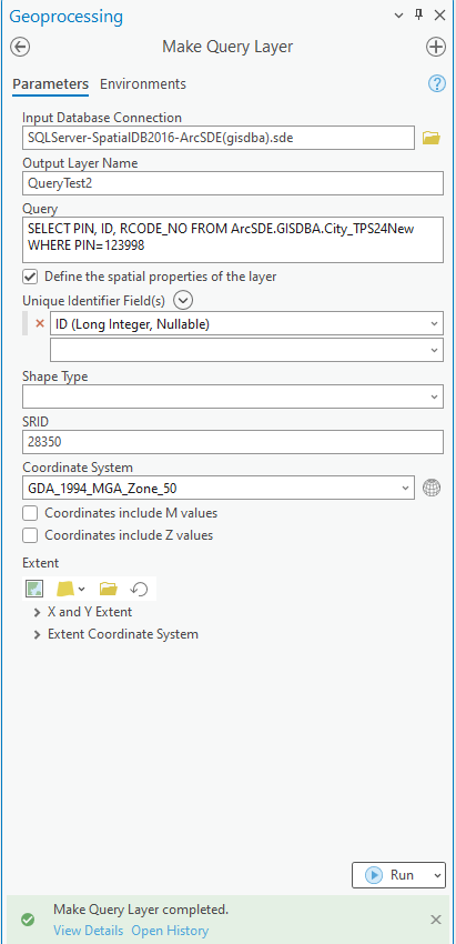

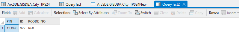

Hello, I am trying to work out why when I query a table why I get a different result than what is contained in the attribute table? Field I'm interested in is RCODE_NO, ID is unique, and the SQL query is a simple one:
SELECT PIN, ID, RCODE_NO FROM ArcSDE.GISDBA.City_TPS24New WHERE PIN=123998

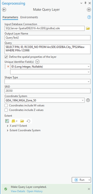

What I find extremely strange about this is I copied the table into a new Enterprise Geodatabase in Catalog and it seems to work as expected?

  1. Can you remove the file geodatabase label from this post, since it’s not a file geodatabase? File geodatabases don’t support query layers.
  2. What version of SQL Server?
  3. What version of ArcGIS Enterprise?
  4. What version of Pro?
  5. Are you sure the field you’ve chosen as the unique ID field is truly unique and doesn’t have nulls?

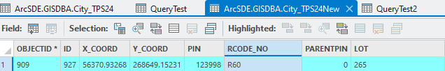

  6. Can you clarify what the problem is? Is the RCODE_NO value wrong in the query layer?

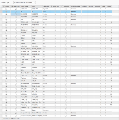

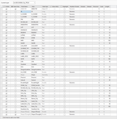

  7. Can you show us a screenshot of the Fields View in ArcGIS Pro for both the underlying database table and the query layer?

5. Upon closer inspection, no the field is not unique and yes there are nulls.
6. The RCODE_NO value in the query layer should be "R60"
7. See below (cannot get query layer field views as the option is greyed out):
