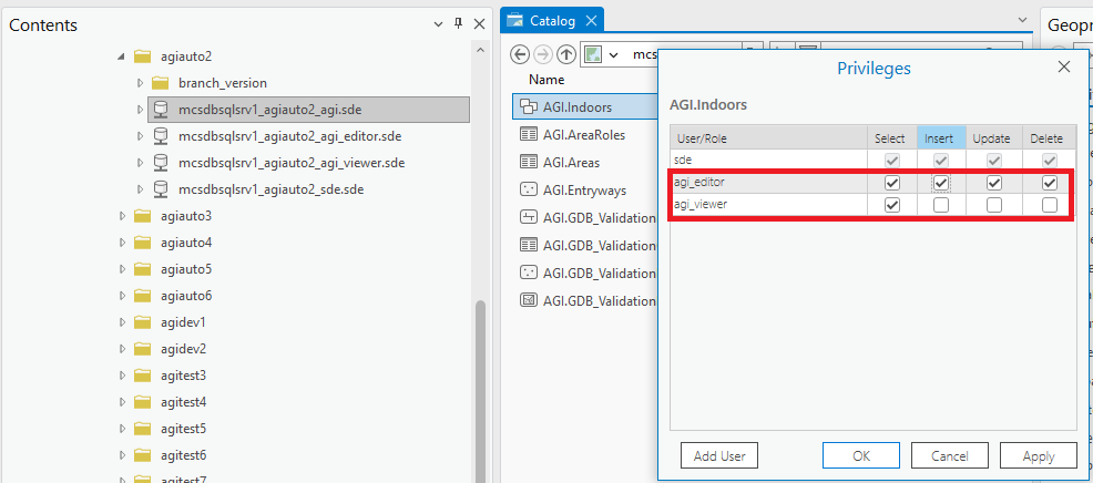

Option A: Use the ArcGIS Pro Privileges Tool
https://pro.arcgis.com/en/pro-app/latest/help/data/geodatabases/overview/grant-dataset-privileges.ht...
Privileges Tool will automatically grant the execute privilege for the store procedures of the data owner user featureclasses and tables.

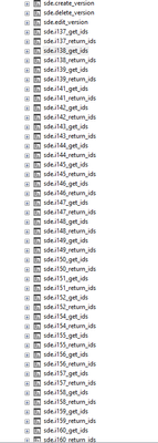

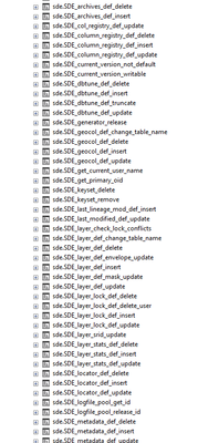

Now, which are the store procedures that you need to grant execute permission. Those are not the ArcSDE Repository Store Procedures.
Those are the data owner user featureclasses and tables Store Procedures, see screenshot below.

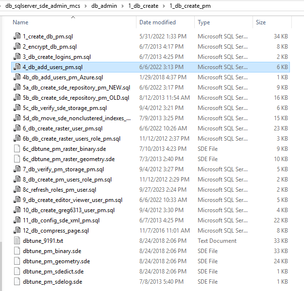

@AndreaB_  the database template scripts that you can download go beyond the database guide books and below is an example of the database script that you will find to create the SQL Server Geodatabase following the best practices to setup the "sde" user, the data owner user, the editor and viewer users.
I hope this clarifies your question.
USE pm
