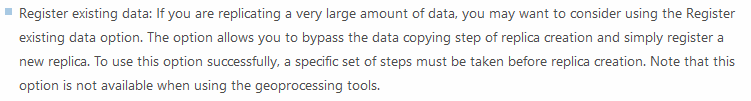

You can create your other database at UAT and then replicate the entire PROD geodatabase.  When replicating an entire geodatabase, it's best to use the option 'Register existing data' when creating the replica:
For example, you could perform the following steps:
  1. Export the PROD geodatabase to an XML
  2. Import the XML to the geodatabase at UAT
  3. Create the replica using the option to 'register existing data'
