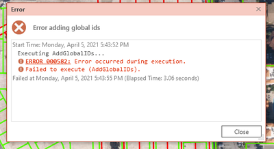

I tried to apply globalid but i got an error. please advise.
JoeBorgione
MVP Emeritus
Google that error and you'll come across this from ESRI.  It looks like a fairly generic, non-specific error so I really don't know what the problem is.  You may want to consult ESRI tech support.
That should just about do it....
AlexP_
@JoeBorgione I found out that I had to stop the map service then applied GLOBALID again.
