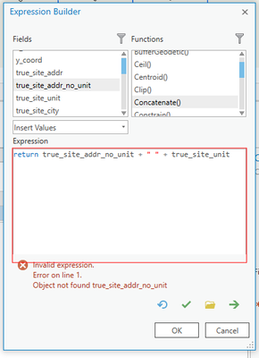

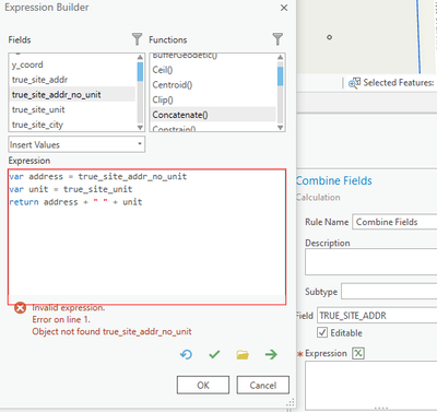

Hello,
I have arcgis pro 2.7.2 and sde. I need to concatenate two fields in same feature class. I found a few samples from geonet. i tested it on my end by using attribute rule but it is not working. can you please assist? thank you.

Concatenate() function works for me. Double-click the function and fieldnames from above list to insert into the expression. Don't type it up.
Expression:
Concatenate($feature.Field1, " ", $feature.Field2)
or
$feature.Field1+" "+$feature.Field2
