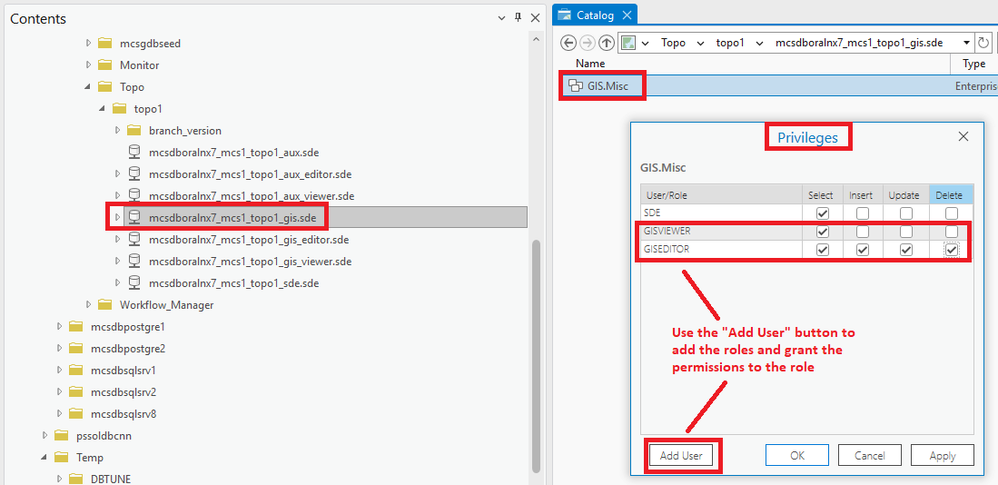

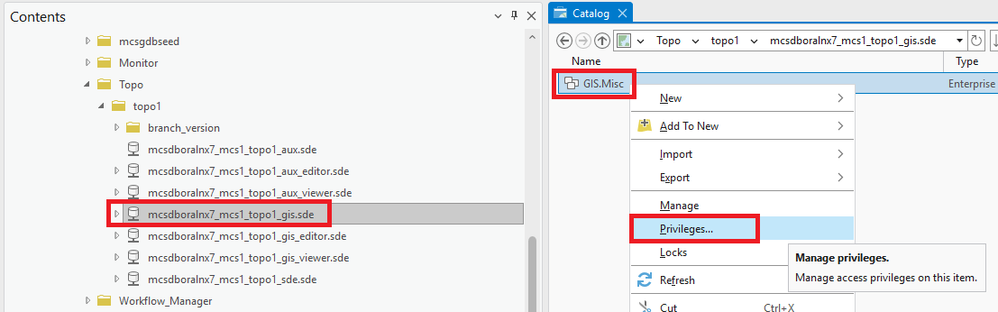

--use the ArcGIS Privileges Tool to grant
--the proper permission to the Roles.

ArcGIS Privileges Tool example.

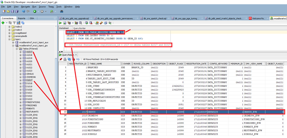

How to determine the Delta Tables - Adds Table, Deletes Table of a Featureclass or Table registered as traditional versioning.
