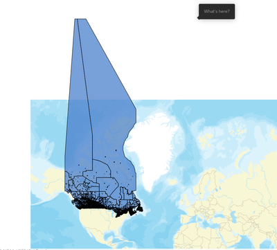

Hi Team,
I am working on Canada FSA Digital Boundary Files which are available on gov website (https://www12.statcan.gc.ca/census-recensement/2021/geo/sip-pis/boundary-limites/index2021-eng.cfm?y...).
I have download this shape files and it is in EPSG:3347 NAD83 / Statistics Canada Lambert coordinate system, now my requirement is to transform this into EPSG:4326 but after changing the projection polygons shape is changed and on arcgis online it is displaying very bad. Can you please help me , how to change the cordinate system so its view should be correct

SaurabhUpadhyaya
Hi,
I tried first option Project(Data Management) to change the projection system.
In Existing Data coordinate system is NAD83/Statistics Canada Lambert Coordinate reference system and i want to change it into EPSG 4326, after changing the coordinates its shape change.
This is the actual data of canada FSA, (NAD83/Statistics Canada Lambert Coordinate reference system)
After applying EPSG:4326 it becomes this shape.

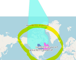

DanPatterson
MVP Esteemed Contributor
Don't use the cartographic version, and add extra vertices to preserve shape during the projection
The above is a plain wgs84 version of the lambert
