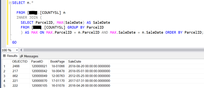

I run this in SSMS and get exactly what I'd expect:
SELECT n.*
FROM [dbo].[COUNTYSL] n
INNER JOIN (
SELECT ParcelID, MAX(SaleDate) AS SaleDate
FROM [dbo].[COUNTYSL] GROUP BY ParcelID
) AS MAX ON MAX.ParcelID = n.ParcelID AND MAX.SaleDate = n.SaleDate ORDER BY ParcelID;
GO

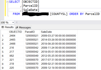

In SSMS, this is what the countySL data looks like:
Source countySL tableSource countySL table
And if I run the query below I get what I need:
functional query in SSMSfunctional query in SSMS

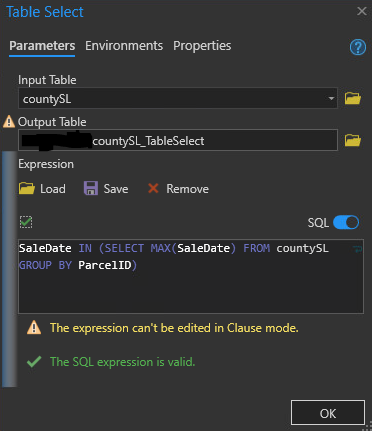

But in ArcGIS Pro model builder, if I use the query below:
SQL in Model BuilderSQL in Model Builder
I get this:
Table Select resultsTable Select results
I've attempted using the Select Layer By Attribute tool as well, and messed with the 'Invert Where Clause' and attempted to switch selection from the source table, but it doesn't work either.  What am I missing?
