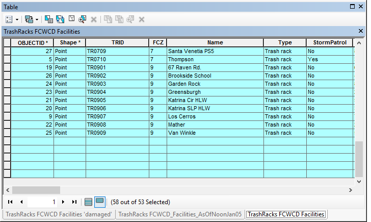

Lost file geodatabase feature class data records while editing; error message "Could not load data from data source. If you can correct the problem, press the refresh button to reload data".
While editing point feature class attributes, got the above error message after saving edits.  I  stopped editing, closed the table and re-opened it.   5 of 58 features were gone; these features were not selected or being edited when the error occurred.
Interestingly, there are still 5 completely blank records in the table (with no ObjectID).  When I selected all records from the Table Options and looked at the selected records ("Show selected records"), the blank records were also shown in the selection color, and the text below table read:  "58 out of 53 selected" (see image below).

table view of records after records lost

Is the file geodatabase (fGDB) stored on your local machine or on network storage?

LizLotz
Network storage - thanks.

It could be possible that there was a network issue during the edit session and it caused partial corruption of the fGDB.
Close out of the MXD and then re-open and then open the problematic table and see if the records are there.

LizLotz
I tried that right after it happened, and also brought in the feature class to a new mxd, but the features were just gone.  Although reopening the mxd has worked in the past when I've gotten that error, in this instance (and the similar issue 2 weeks ago) it did not.
