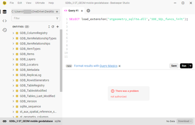

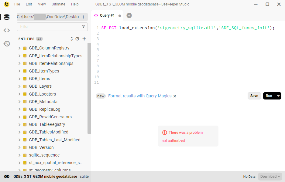

Using Beekeeper Studio SQL client, I connected to the mobile geodatabase and tried to run this SQL statement:
SELECT load_extension('stgeometry_sqlite.dll','SDE_SQL_funcs_init');
But I get an error:
not authorized

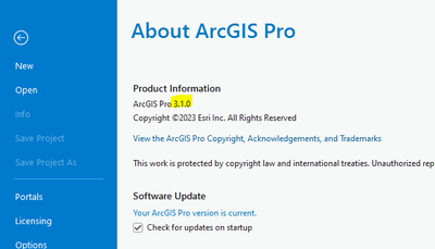

Yes, the mobile geodatabase was created in Pro 3.1.0.

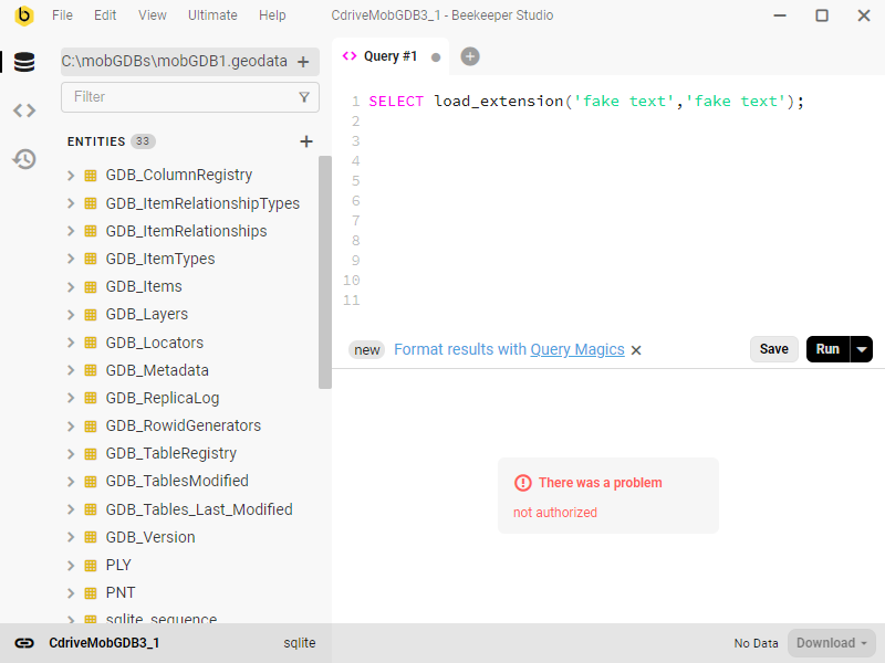

I actually did a different test where I replaced the proper text arguments with 'fake text', just to see if I'd get a different error or not:
I get the same error.
So I guess that means the error is caused by the mobile GDB SQLite database, possibly indicating that extensions are disabled in the SQLite database? So the problem isn't caused by the .dll or ST_GEOMETRY.

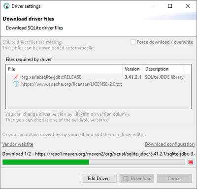

For what it's worth, DBeaver popped up this message, "SQLite driver files are missing."
So I downloaded the drivers using DBeaver.
