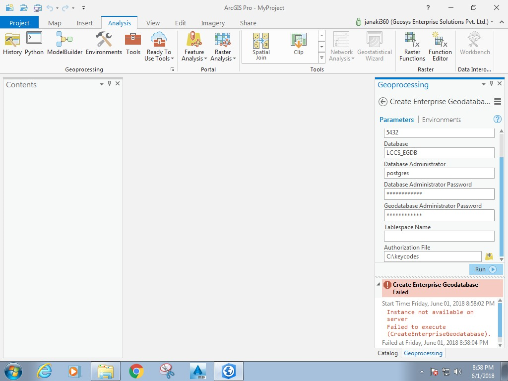

I am having an issue in Enabling Enterprise Geodatabase. The architecture is as follows.
We have three VM's.
First VM - ArcGISPro 2.0(Installed Successfully)
Second VM - Postgresql (postgresql-9.5.3-1-windows-x64-------Installed Successfully)
Third VM - Server. (ArcGISServer10.6-------Installed Successfully).
Now when I am creating a Enterprise Geodatabase from the First VM where ArcGIS Pro is installed - I am getting an Error saying "Instance not available on Server - Failed to Execute Create Enterprise Geodatabase).
I have copied the Keycodes file generated from Third VM - Server. (ArcGISServer10.6) and has put in the local system.
How to enable this.

I tried with all the options by giving lower case only and not any mixed characters - But still it is the same. Please find the below for the same.
JanakiGattu1
Hi George,
RexRobichaux2
It looks like in the tool inputs you have the default Postgres port 5432 specified as the Instance name input- is this valid per your configuration? There should be no need to specify the port number if Postgres is running on the default port 5432. If you have a running instance / service on the Windows server- try inputting the name of the database instance (might be the server name if you're unsure) and see if that works. Hope this is helpful!
