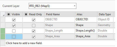

If you must rename them, for whatever reason, you can open the Feature Class in the  "Data Design > Fields" editor and change the alias of this column.  I like to hide these 2 columns, so I uncheck the Visible checkbox.
