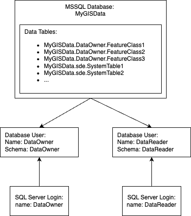

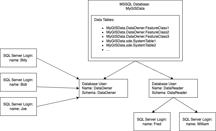

This is what I'm envisioning. I would like a user on the database that can create and "own" all the data, this is called "DataOwner". There are three people who have their own logins, Billy, Bob, and Joe. I think those logins should be mapped to DataOwner so whenever they login, if they create a new feature class, it ends up being named MyGISData.DataOwner.FeatureClassX.

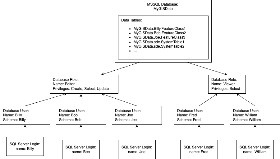

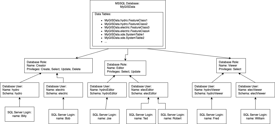

If I included making different roles for creation, editing, and viewing data, the diagram would end up looking more like this. You could have any number of SQL server logins mapped to a database user which is mapped to a role that has a particular set of privileges:
Is this possible? Is it advisable? If it's not, how do you get ahold of the data owned by someone else when that person leaves the organization? Or are people just creating logins and users like below and just letting multiple people use the same credentials (doesn't seem like a good security practice)?
I think most people set up their database something like this, but then you wind up with ownership of feature classes being tied to specific person which I'm trying to avoid:

The simplest way I would recommend to accomplish this the following:
You just need to make sure that you secure the PW to the SDE and Data Owner accounts. If a person leaves the company, it may be best practice to update the PW for those users as needed.
This should prevent issues with data ownership being a "free for all" in your organization.
All the "management" of the tables will be done by the data owner, to simplify administration of these tables.
There may be some other ways, but this has been successful in the past.
Hope this helps!

I do not recommend using a domain headless account as a data owner user in the SQL Server Enterprise Geodatabase, there are many reasons for that, but let's just say this is not a good practice for security and maintenance purposes, instead I always recommend to my customers to create a normal SQL Server user to be the data owner user, and if you want users to connect to the Geodatabase with their Windows Domain Login, then you can add those logins to SQL Server and add each domain login to the database and grant a database role with permissions to edit and view the data. This is a much better approach.
Note, you can also create an Active Directory (AD) Group for editor users and another for viewer users, then add the AD Group as a SQL Server Login, yes this is possible, then you add the AD Group as a user in the SQL Server Database, then in the database you create a database role for editor and another for viewer and then grant the proper role to the user. This way if someone needs editor access or viewer access you just need to go to the AD Group and add the user Domain Login into the proper AD Group. I have done this setup before and it works fine with Geodatabases in SQL Server.
