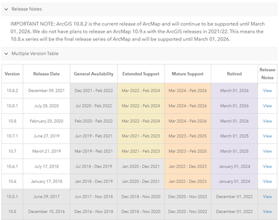

By when is the ESRI geometric network going to be supported? When does the support end for the geometric network?
Can't seem to find it anywhere. Thank you.

ArcGIS Pro only support the new Utility Network and Trace Network and does not support Geometric Networks.
ArcGIS Desktop (ArcMap/ArcCatalog), that supports the Geometric Network, has reached end of life, no more new releases, and customers are encouraged to move to ArcGIS Pro and Utility Network and Trace Network.

Thank you so much for the response! So basically geometric network is expiring in Spring of 2026. Is there a debate for extension?
The reason I am asking is because the upper management in my company doesn't intend to switch to UN anytime soon. They are saying that ESRI will extend the support for ArcGIS Desktop/geometric network. That's why I feel like I need a straight answer from ESRI.

Question: So basically, geometric network is expiring in Spring of 2026. Is there a debate for extension?
Answer: No, there is no plans for extension at this time.
Esri Support ArcMap 10.8 (10.8.2)
