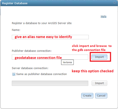

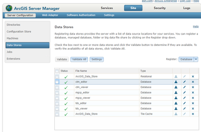

You need to first add the "Database" Data Store to ArcGIS Server, then you will be able to Publish from ArcGIS Pro / ArcMap.
Manage registered data stores—ArcGIS Pro | Documentation
Register your data with ArcGIS Server using ArcGIS Desktop—ArcMap | Documentation
ArcGIS Server Manager > Sites > Data Stores >
Click "Register: Database" > Click Import > Browse for the Geodatabase Connection File.
Click Create
Click Validate All
Note: if your map document has layers from different geodatabase connection users then you must register each one as a new Data Store in Server Manager.
