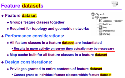

yockee
Hi.. i know this has been ages ago.
But, i have to comment on this as i just found new info. anyway, in general, there is overhead in having FD. Here what some say :
https://esriaustraliatechblog.wordpress.com/2011/10/06/can-you-use-feature-datasets-as-logical-folde...
and from Geodatabase Tuning and Performance (Gillian Silvertand and Greg Cunningham)
