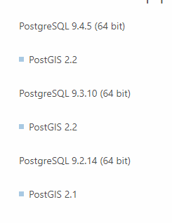

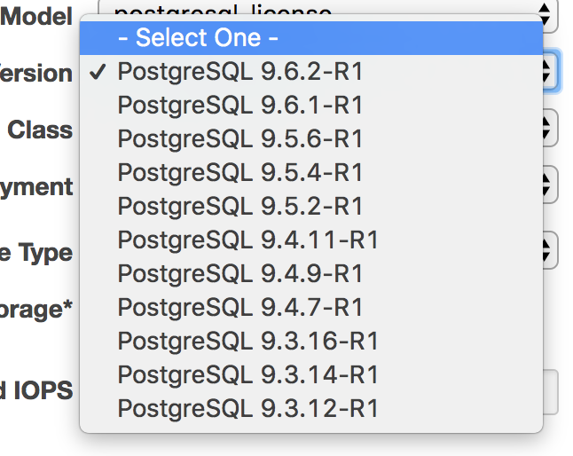

venkateswarlunittala
Hi George Thompson
Thanks for your reply, We will try with 9.4.5 Postgres
Venkat

VinceAngelo
Esri Esteemed Contributor
Any of the PG 9.4.x releases (where x >= 5) are supported with ArcGIS 10.4.1. Only 9.4.5 was certified.
