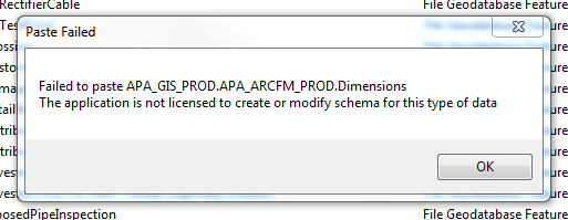

I am trying to create a local file geodatabase from our MS SQL Server SDE database but get the following error.
The layer is a dimension layer created using ArcFM in ArcGIS 10.2.1
I have been able to copy all other layers except this one particular dimension layer.
Any clues would be very much appreciated.

Hi Dean,
It looks like you do not have the correct Desktop extension enabled for that layer.
I have seen a similar error when copying over Network Datasets and not having the Network Analyst extension enabled in ArcMap/ArcCatalog.
I am going to take a guess and think you may need to check-out a Schematics license in Desktop.
ArcGIS Help (10.2, 10.2.1, and 10.2.2)
Let me know how this goes?
-George

Thanks George, I think it was more a licence issue as I was trying to use a lower level than I needed. When I change to the higher licence level it seemed to work but I also found that not all features were copied but that seems to be a separate issue.
