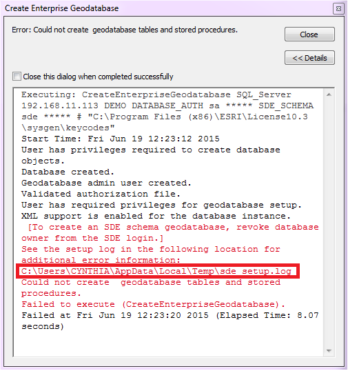

I have a problem creating an enterprise geodatabase, two days ago I have created a geodatabase throw ArcMap with an SQL Server connection and everything went well, but today I'm trying to create another geodatabase using the same SA and SDE Credentials but it fails when running the process, and this message appears:
And the route marked in red shows the following message:

It looks like you gave "db_Owner" role to the SDE user, remove that for the creation of the geodatabase.

If you look at the error message it says.....
"...revoke database owner from the SDE login..."
I do not think it has anything to do with the password.
