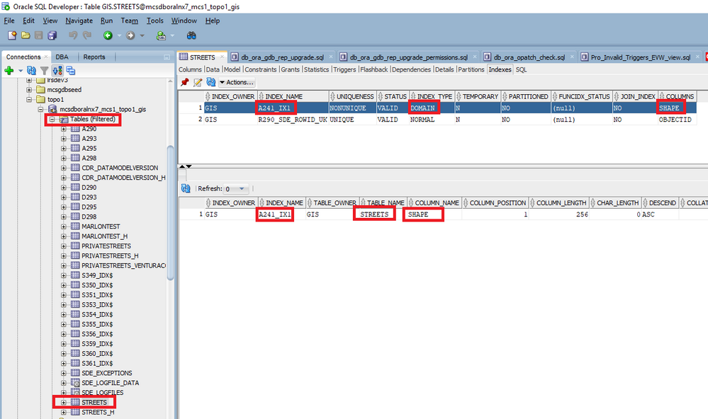

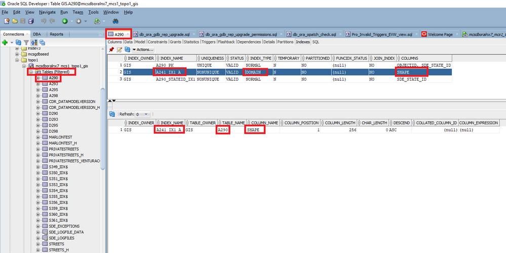

Question: What are the differences between the indexes Axxx_IX1and Sxxx_idx$?
Answer: Axxx_IX1 is a domain index while Sxxx_idx$ is a table.
See more details in the example below.

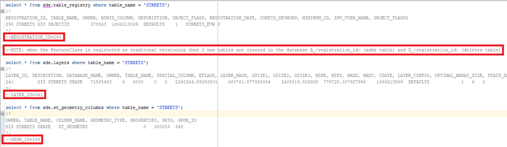

The Axxx Table & Index is for data that is Registered as Versioned, and holds information about objects that have been created or edited.
https://desktop.arcgis.com/en/arcmap/latest/manage-data/geodatabases/versioning-terms.htm
The Sxxx Table is a Spatial Index for data that uses the ST_Geometry spatial data type.
https://desktop.arcgis.com/en/arcmap/latest/manage-data/using-sql-with-gdbs/spatial-indexes-and-stge...

If the featuereclass/table in the geodatabase is registered as versioned (traditional) then the A & D tables are created, if you unregister as versioned (traditional) then the A & D tables are removed.
