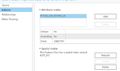

The Normal and Domain indexes become "unusable". I know I can rebuild Indexes using ArcGIS Pro but I think its to tiresome becasue I have 1000 feature classes. I prefer using phyton script or query / plsql. Is there anyone here can help or at least point me to a direction?
Moreover, I tried to delete the attribute Index. But the button is greyed out. Why ? I can rebuild the spatial index just fine. See the picture below:
How can I delete and then rebuild the Attribute Index again with the same name (or with deifferent name, its fine) ?

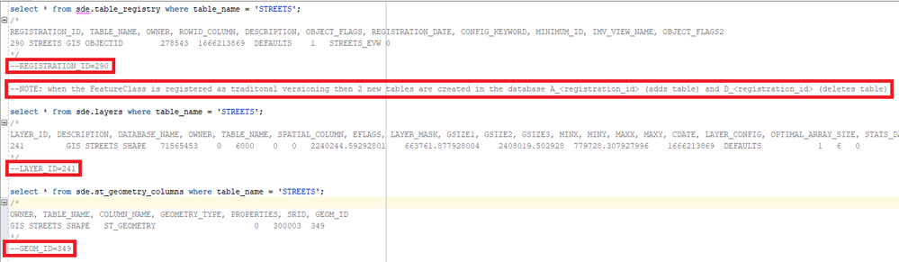

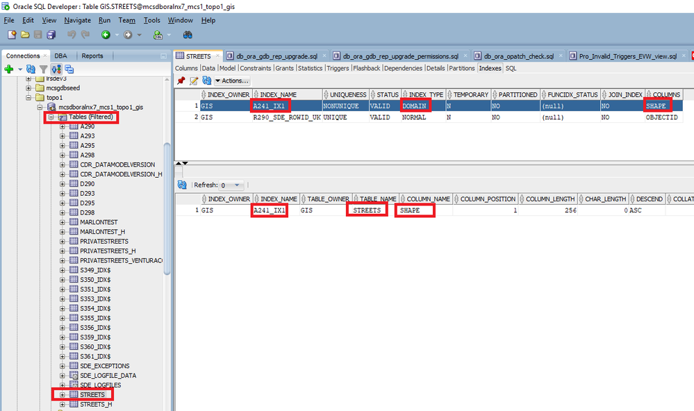

Example:
--REBUILD INDEXES
--TABLE STREETS--
ALTER INDEX A241_IX1 REBUILD TABLESPACE GIS_BINDEX ONLINE PARALLEL 4; --index_type=DOMAIN
Error report -
ORA-29871: invalid alter option for a domain index
29871. 00000 - "invalid alter option for a domain index"
*Cause: The user specified an invalid option for altering a domain index.
*Action: Reissue the alter statement with a valid option.
--GENERATE THE INDEX SQL DDL THEN DROP THE INDEX AND TRY TO RECREATE ON ANOTHER TABLESPACE!!!
DROP INDEX "GIS"."A241_IX1";
--Index "GIS"."A241_IX1" dropped.
CREATE INDEX "GIS"."A241_IX1" ON "GIS"."STREETS" ("SHAPE")
INDEXTYPE IS "SDE"."ST_SPATIAL_INDEX" PARAMETERS ('ST_GRIDS=6000:0:0 ST_SRID=300003')
TABLESPACE "GIS_BINDEX";

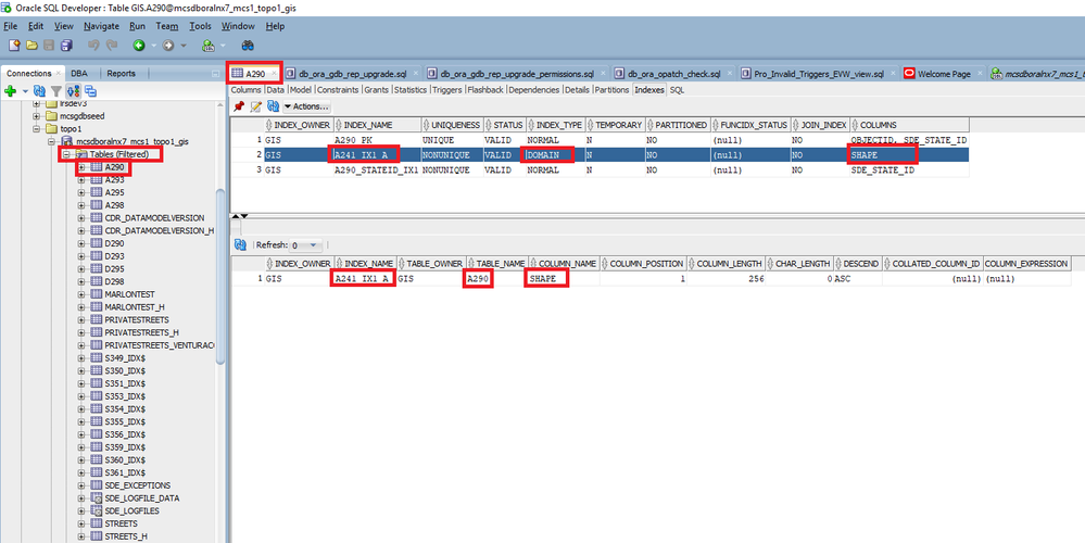

--TABLE A290--
ALTER INDEX A290_PK REBUILD TABLESPACE GIS_AINDEX ONLINE PARALLEL 4; --index_type=normal
--Index A290_PK altered.
ALTER INDEX A241_IX1_A REBUILD TABLESPACE GIS_AINDEX ONLINE PARALLEL 4; --index_type=DOMAIN
--CONCLUSION: CANNOT MOVE A DOMAIN INDEX !!! SEE EXAMPLE ABOVE WITH DETAILS !!!

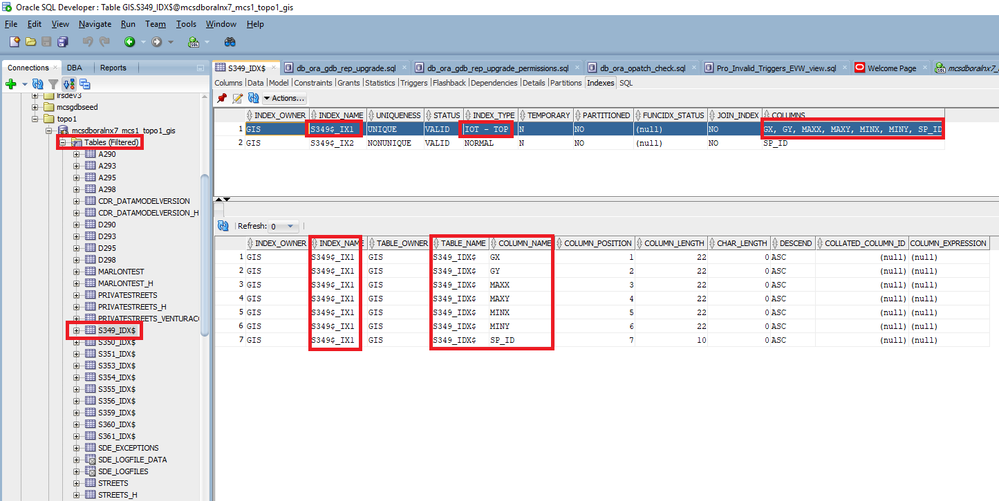

--TABLE S349_IDX$--
ALTER INDEX S349$_IX1 REBUILD TABLESPACE GIS_SINDEX ONLINE PARALLEL 4; --index_type=IOT
Error report -
ORA-28650: Primary index on an IOT cannot be rebuilt
28650. 00000 - "Primary index on an IOT cannot be rebuilt"
*Cause: An attempt is made to issue alter index rebuild on IOT-TOP
*Action: Use Alter table MOVE to reorganize the table(IOT)
ALTER TABLE S349_IDX$ MOVE TABLESPACE GIS_SINDEX PARALLEL 4;
--Table S349_IDX$ altered.
ALTER INDEX S349$_IX2 REBUILD TABLESPACE GIS_SINDEX ONLINE PARALLEL 4; --index_type=normal
--Index S349$_IX2 altered.

The option to delete the attribute index Rxxx_SDE_ROWID_UK  is grayed out because it is the unique index of the objectid field.

yockee
Hi @MarceloMarques
The "Rxxxx_SDE_ROWID_UK" is greyed out and I see it's status is "UNUSABLE". If its Unusable, how can I  make it usable again ? I want to delete and rebuild it in order to make it usable again..
Thanks
MarceloMarques
You will need to manually drop the index in Oracle via SQL Plus or Oracle SQL Developer then open ArcGIS Pro and rebuild the index.

--DOMAIN INDEX--
SELECT * FROM user_indexes where index_name = 'A241_IX1';
INDEX_NAME, INDEX_TYPE, TABLE_OWNER, TABLE_NAME, TABLE_TYPE, UNIQUENESS, COMPRESSION, PREFIX_LENGTH, TABLESPACE_NAME
A241_IX1 DOMAIN GIS STREETS TABLE NONUNIQUE DISABLED <null> <null>
"ALTER INDEX <index_name> REBUILD ONLINE PARALLEL 8 TABLESPACE <tbs_name>;"
ALTER INDEX GIS.A241_IX1 REBUILD ONLINE PARALLEL 8 TABLESPACE GIS_SINDEX;
