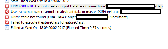

But when I tried to import one feature class in user SCHEMA it gave me an error :
Anybody have an idea about this issue. I think that there can be some oracle grants missing, any idea?

Did you connect to the User-Schema geodatabase through the Database connection?
The error seems to indicate that you are connected to the Master SDE gdb and trying to load data in that.

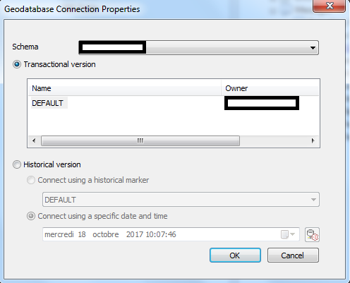

Thanks for your reply. Infact I am trying to connect to user schema through SDE connection:
My geodatabase connection properties point towards user schéma bu default version.
So according to my understading, I am not connecting to SDE directly.

That is fine, there will be a Default version owned by the Schema owner when you create a User Schema gdb.
So, are you connecting as the same user as 'user schema' that you created for the User Schema gdb. Only the schema owner can load data into a user-schema geodatabase
