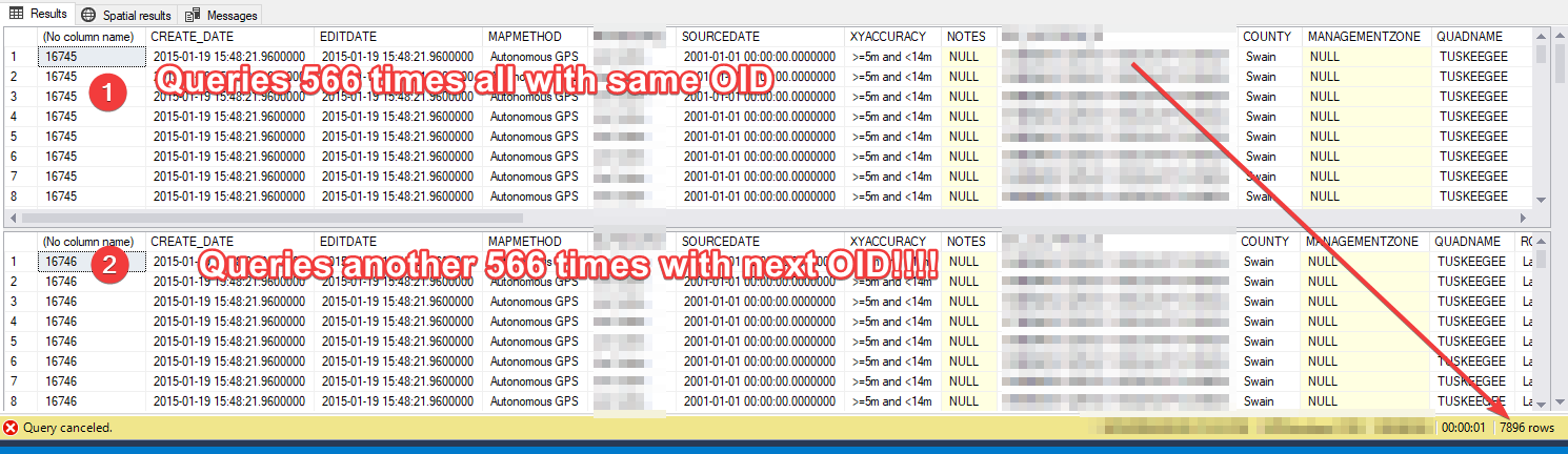

Which results in the whole thing looping as many times as there are objects meeting the where clause. E.g it's selecting all 566 rows, 566 times.

10.7.1.2.4, SQL 2014 ENT, Storage Type Geography. What's different from your post is, my source and destination tables are in different database........
