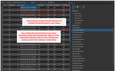

I recently took an ESRI class on Branch Versioning that was focused on the process of preparing data for Branch Versioning. I am now configuring my test data and of course I hit a snag that was not covered in the ESRI class, attributed relationship classes. Do attributed relationship classes need to to be configured for Branch Versioning with editor tracking enabled?

Well I finally have my test data set up to use branch versioning. I completed the steps you recommended with the attributed relationship classes only to find out the process initially didn't change the fact that the relationships still did not work.
The other key item to getting attributed relationship classes working in branch versioning is to make sure those relationship class tables are in the published feature layer that you intend to create named versions from. I could not find this information in any of the ESRI documentation that I read nor was the topic addressed during an all day training I received from ESRI on Branch Versioning.

My initial attempt at creating branch versioned data did not have any failures when editing feature geometry or rows from standalone tables rows that utilized relationship class tables. The biggest issue I had was not finding out that relationships utilizing attributed relationship classes required that those tables also be published with the origin and foreign tables/feature classes. I will admit that I am a skimmer when it comes to reading lengthy technical documents and I would have saved some time if I had read thru the documentation thoroughly. However I strongly feel that this case should be included in the current training because of how common the use of attributed relationship classes are present in many GIS spatial data environments/systems. Also it would be helpful to add a warning during publishing that points out relationship class tables may be missing (unless I missed those warnings because of skimming) . I do have my test data up and running and it is working fine.
