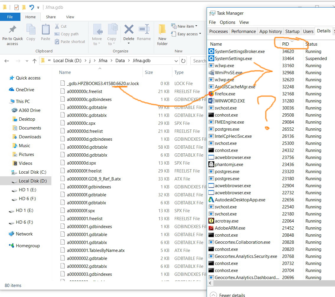

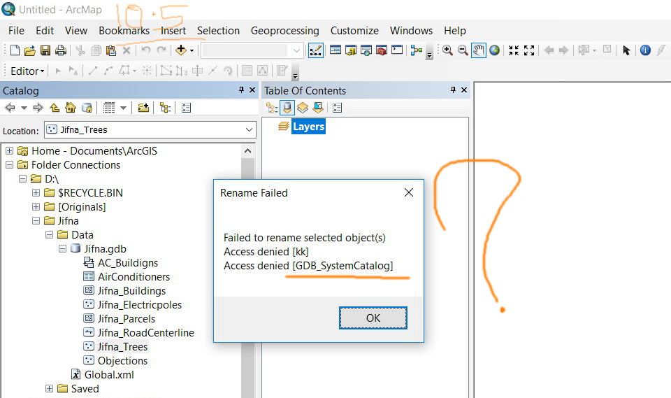

I couldn’t figure out why the ArcMap fails to delete a “feature class” (Access denied GDB_System Catalog) knowing that this feature class is not published in ArcGIS Server.

You can try to take a look at the .gbd contents in Windows Explorer and see if there's a .lock associated with a PID on the machine:
The highlighted value is the process creating the lock, for example ArcMap.

I can’t find that number in the PID field as shown in the screenshot below. What could be the issue here?

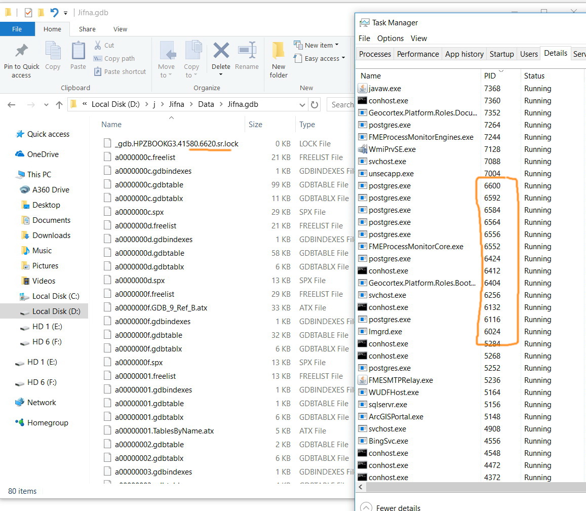

Hard to say, looks like that PID is 6620, but your screenshot is sorted descending starting at 34620.  You don't see anything if you scroll down to 6620?
JamalNUMAN
Legendary Contributor
Scrolling down doesn’t show that specific number.

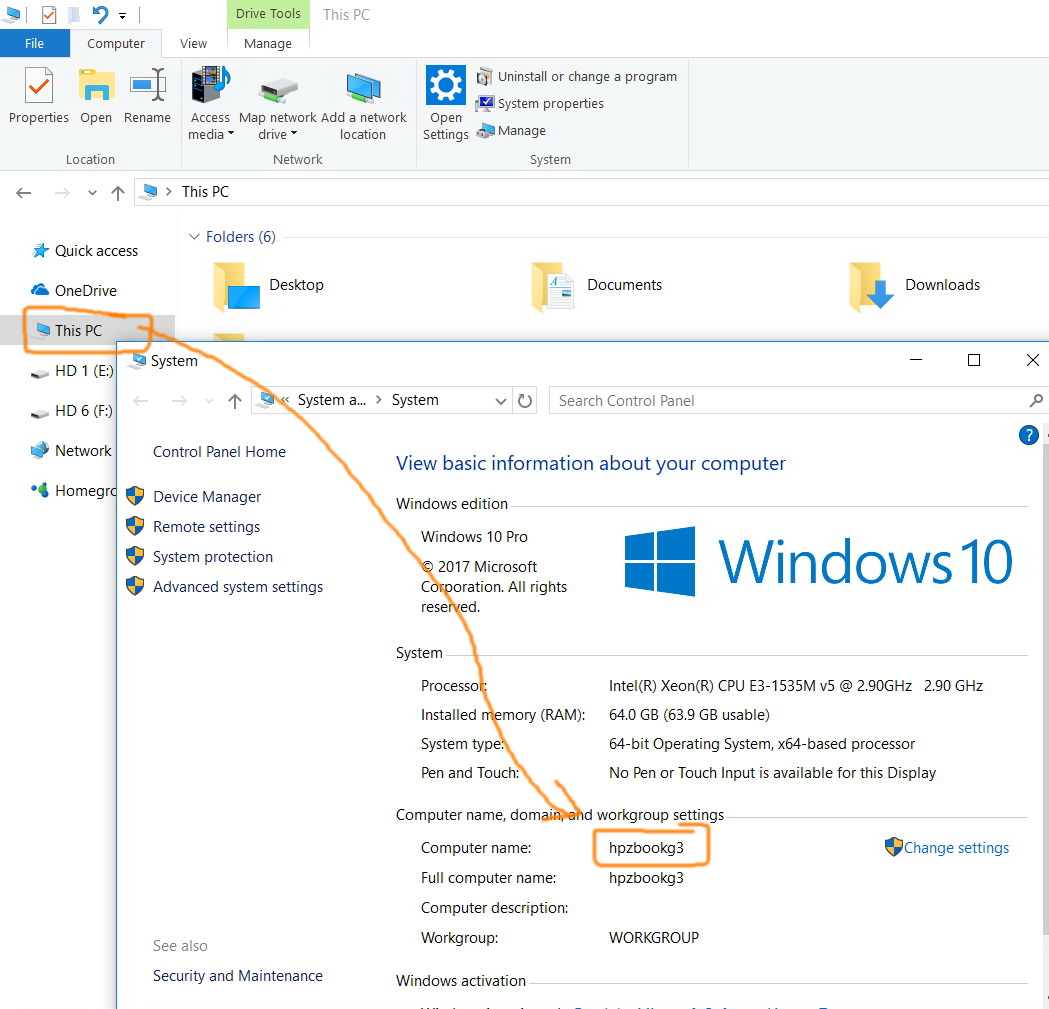

The first element in the lock is the machine name.
Is HPZBOOKG3 the machine you are working on?
If not you should look for process 6620 on HPZBOOKG3 machine.
JamalNUMAN
Correct. hpzbookg3 is my local machine. Nevertheless, the 6620 is not there!

It appears to be an orphaned lock.  Orphaned by what process I can't say, but there are a string of postgres.exe and GeoCortex process in that range, so maybe there was another process from one of them that crashed.
Try running Compress—Help | ArcGIS Desktop  Compact—Help | ArcGIS Desktop   to see if it clears the lock.
