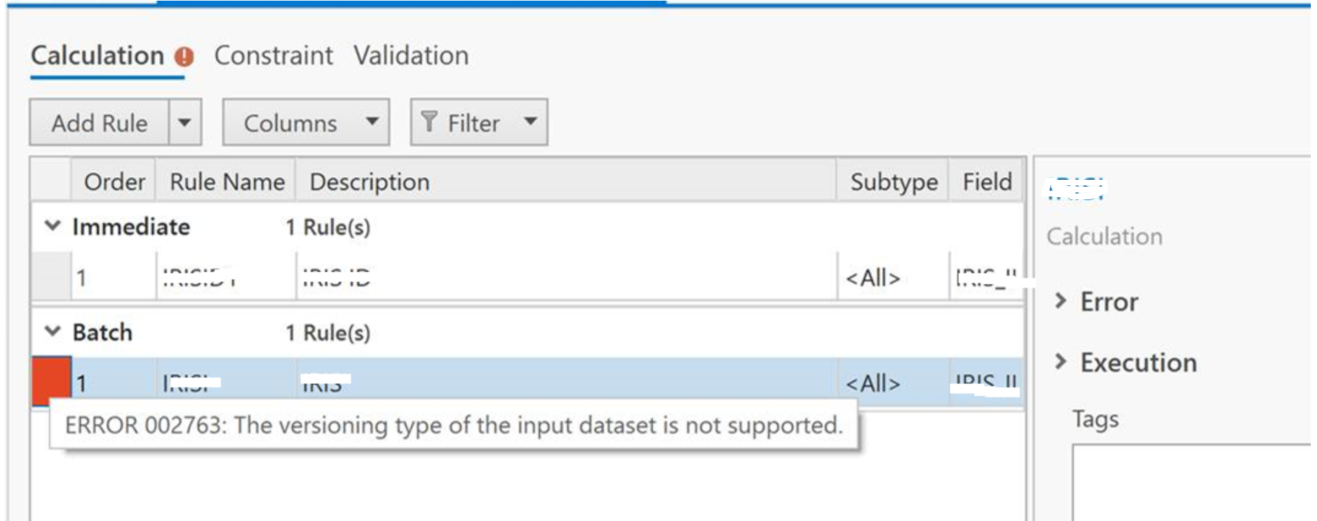

Hi Team,
    We are trying to apply Batch Calculation attribute rules on version feature class (which is in Branch versioned database). But we are getting below error.
Whereas Immediate calculation rule is getting creating without any issues.
This is the same case for Validation rules.

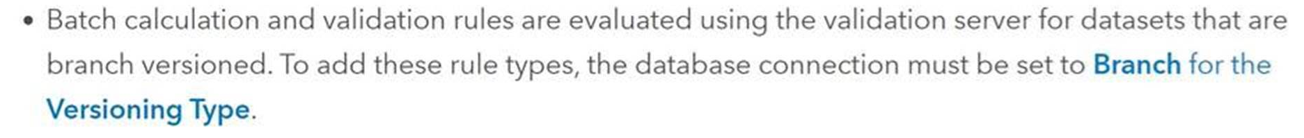

As per documentation,
Can you please help us here.
