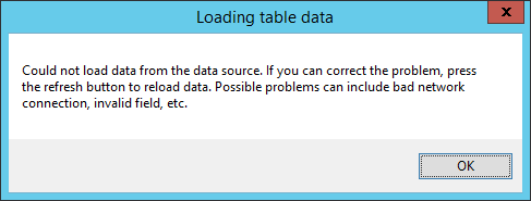

However, when I add some records including attachments to the related table (using FME), and view the data in ArcMap, after some time (about 0,5 to 3 hours) the related table seems to get corrupt.
In ArcMap I get this message when I try to open the table:
And when I try to read the data from the table in FME, no records are imported.
The feature classes and attachments table however stay up and running.

Those type of errors seem to correlate to network issues.
When you get that error message, noted above, can you access "Feature Class 1" or any other feature class in the fGDB?
What if you bring the fGDB locally and do all the edits and then copy to the network?
It is indeed possible to access "Feature Class 1" or "Attachments", the error message only appears when I try to open the attribute table of "Related table".
