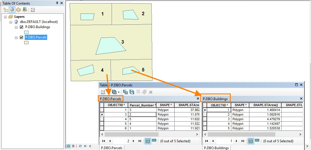

I have a parcel layer, on top of it the buildings layer lies, each parcel contains a building, I want to create a spatial view that automatically spatially join the building with parcels (using intersect) in order to append the Parcel_Number attribute to the buildings features. Is there a way to do this?
The two layers are in enterprise geodatabase in SQL Server 2014
