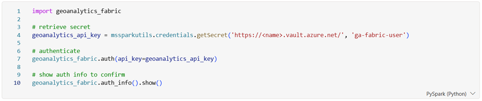

Within your Fabric notebook, to update your public preview notebook to work in general availability, you will need to add an authentication call prior to using any of the GeoAnalytics for Fabric functionality.  Once you have authenticated, your existing GeoAnalytics for Fabric code should run as expected.
You can authenticate using your administrative user credential or an API key.  We recommend using API keys as well as securing all credentials using a method such as provided by Azure Key Vault for referencing these credentials within the Fabric environment.
Additional details on authentication methods are provided in the developer documentation.

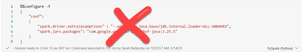

Remove configuration cells from public preview
In the public preview, there was a known limitation with plotting base maps using st.plot. That has been removed with the general availability release.  If you have a configuration cell that you were running at the start of your notebook to enable basemap plotting with GeoAnalytics for Fabric you can remove it.
