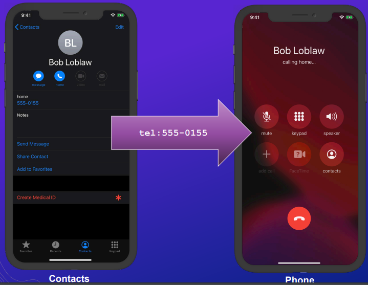

App linking, sometimes called deep linking, is not an Esri-specific term, and you likely take advantage of app linking every day. This capability can be used in many different ways, but the general idea behind app linking is that it allows separate applications to communicate with each other. A common example – you have the Contacts app on your cell phone open, and you’re looking at a friend’s contact. When you click on the “call” button, app linking is the mechanism that then opens the Phone app and dials that phone number.

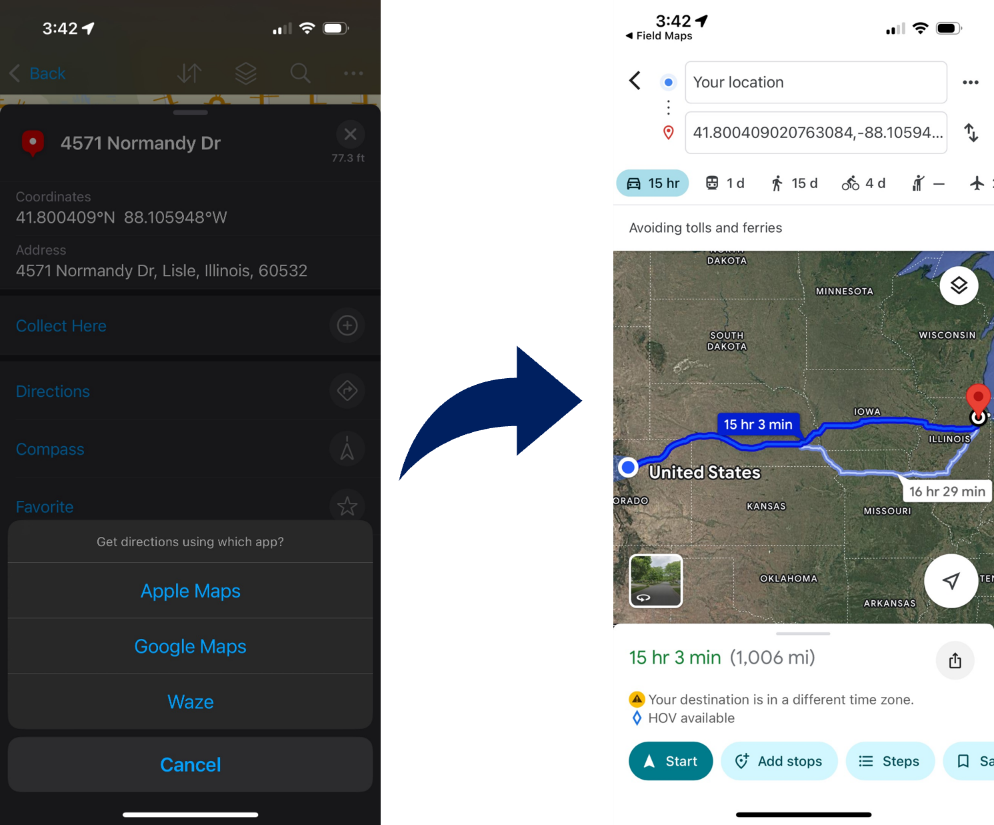

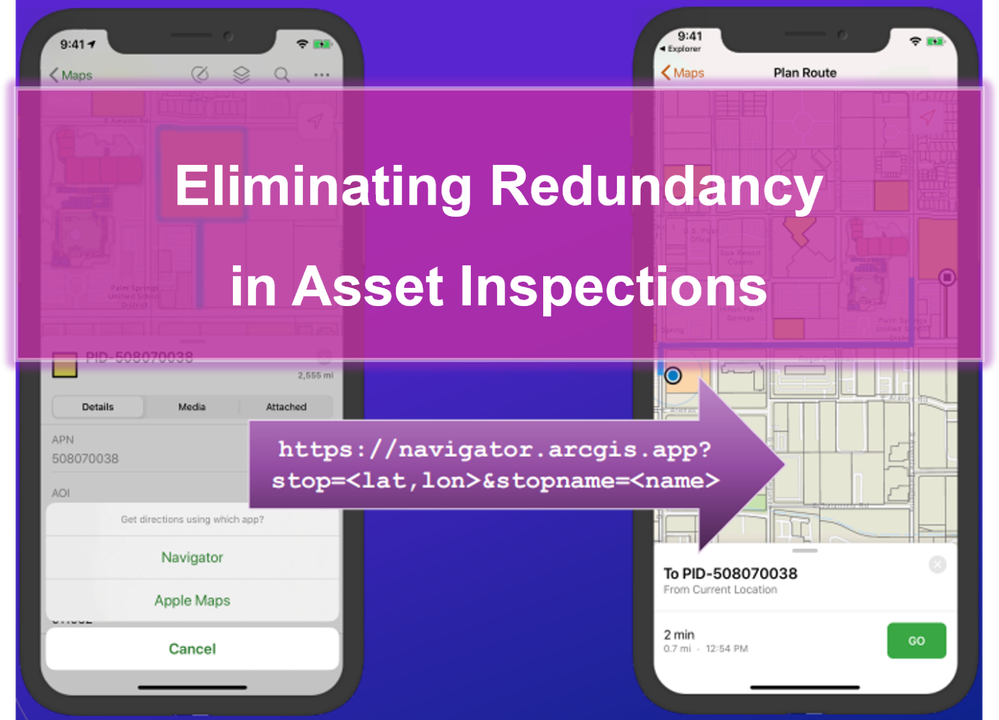

A more Esri-specific example – you're in Field Maps, and you’ve selected the asset that needs to be inspected. Within the pop-up for that asset, you click “Directions.” App linking is the mechanism that not only opens the navigational app of your choice, but also inserts the coordinates of that asset as the destination, without any copying or pasting from you.

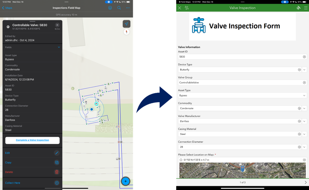

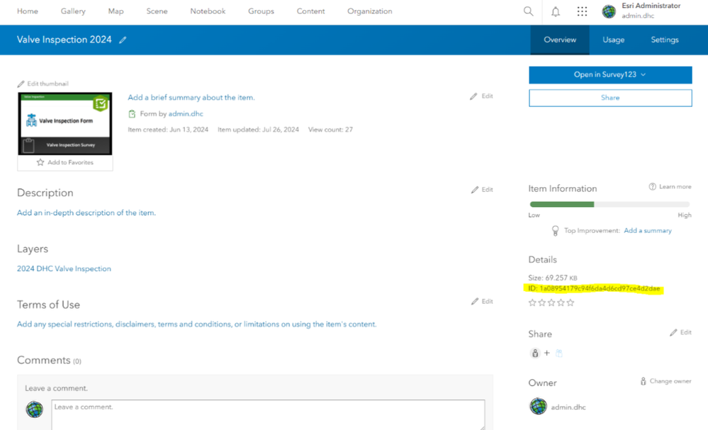

App linking between ArcGIS Field Apps allows the field worker to view the asset in Field Maps that needs to be inspected, click on a special link that can be found in the pop-up associated with that asset, and open the Survey123 app directly from there. Not only this, but that specialized URL can open the correct survey (using the desired survey’s unique item ID) and pre-populate the survey with information about the asset from the asset record in Field Maps. All of these steps happen with the click of a button, creating a seamless experience for the field worker.

The workflow is designed so that the field worker views the asset in Field Maps and clicks on a link embedded in the pop-up. That link then opens Survey123, creates a new survey record, and pre-populates the asset’s attribute information into the appropriate places within the new survey record.
This saves the field user from having to copy over all of the information from the asset record into the asset inspection record, in turn saving the utility mobile worker time, energy, and potential frustration. This app linked integration eliminates mistakes and typos that can be made with paper forms.

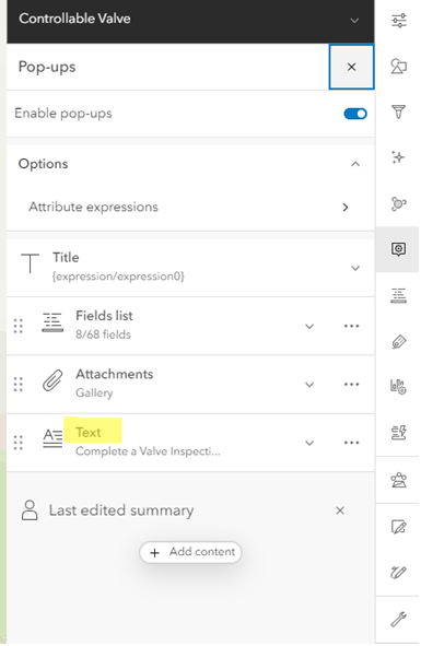

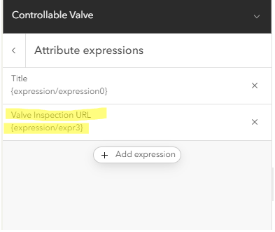

App linking works by using a specialized URL (called URL schema or URL parameters) to open an external app and communicate information. When utilizing app linking in Field Maps, this specialized link is constructed as an attribute expression in a web map...
... and then that attribute expression is put into the pop-up via a text element in order for the end user to access it.

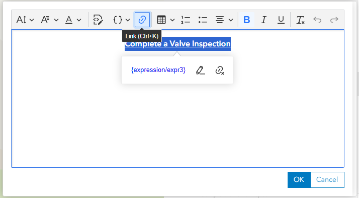

Within that text element, the attribute expression is inserted as a hyperlink. The attribute expression represents the specialized link to the desired survey, as well as the instructions directing the pre-population of information from the asset’s fields into the appropriate questions in the asset inspection survey. From the end user’s perspective, they are simply clicking on a link; this creates a seamless experience for the field worker and increases the likelihood that correct information is entered the first time around.
