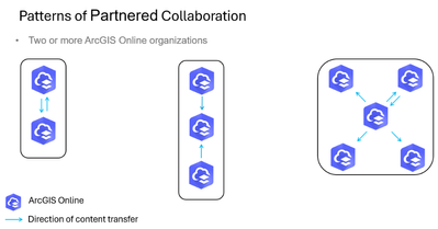

There are two types of collaborations – partnered and distributed.
Partnered collaborations only involve ArcGIS Online organizations – here are a few patterns of use.
An example for how to use partnered collaborations would be sharing asset data through your utility’s ArcGIS Online with the local fire department’s ArcGIS Online during an ongoing wildfire.

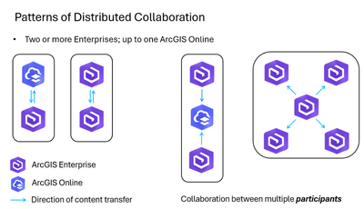

On the other hand, distributed collaborations are collaborations that involve an Enterprise organization. This can mean multiple Enterprise organizations, or one Enterprise and one ArcGIS Online. Below are a few potential patterns of use – the diagram on the far right could represent your utility’s Enterprise organization sharing asset location information with other Enterprise organizations (like the local police department, fire department, city government, etc.)
Distributed collaborations are commonly used among natural gas utilities to share information between their Enterprise and their ArcGIS Online, as in the diagram on the far left. This could look like anything from resilience monitoring to having a continuous stream of audits from your ArcGIS Online into your Enterprise.

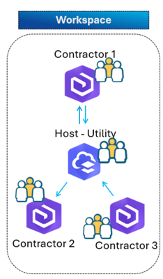

A workspace is a conceptual space that represents a project, an initiative, or another organizing principle. For example, you might create a collaboration with a contractor that does various kinds of work for your utility – within that collaboration, you’d create different workspaces for each kind of work (Yard Restoration, Leak Survey, etc.) to keep things organized. Each workspace has a single group associated with it within all organizations participating in the collaboration. The diagram below shows an example of a workspace with four participants in it – this could represent your utility and three contractors who are all surveying for leaks, for example.

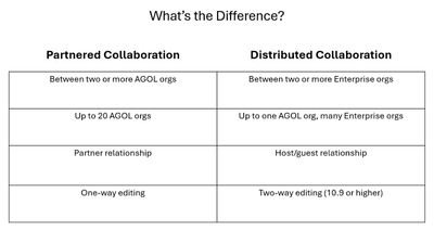

Deciding the right path forward for your utility depends on a number of factors, including the type of access to the data required by the contractors, the placement of the responsibility of managing logins and licensing, and familiarity with ArcGIS that each contractor has.
See the chart below for a summary of the differences between partnered and distributed collaborations.
The chart above mentions two-way editing – two-way editing is a way to share data between two organizations, have the ability to edit data belonging to another organization within that collaboration, and then share those changes between the organizations. Two-way editing is only available in distributed collaboration, as the chart above mentions. As a natural gas utility, two-way editing could be used in a collaboration with the contracting organization in which corrections could be made to submitted inspections. Just as a reminder, two-way editing is optional and permissions can be managed as needed.
