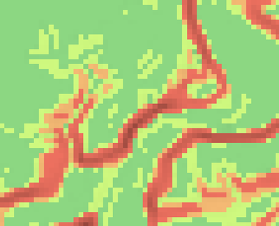

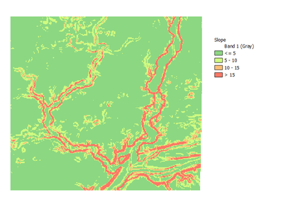

Once you have your raster(s), I'd visualize the slope raster on a color ramp with discrete intervals, in order to highlight >15% cells. Here's my home area, admittedly, a bit flat. But I can still easily see which areas are a "no go" with discrete symbology.
If you output the curvature raster, too, you could symbolize that on a centered black-to-white-to-black color ramp and set the layer blend mode to multiply, and you'll see the slope classes shaded darker as the cell's curvature diverges from flat. Then you can see where, if you had to cross a high-slope area, whether the ground there is flat or not.
