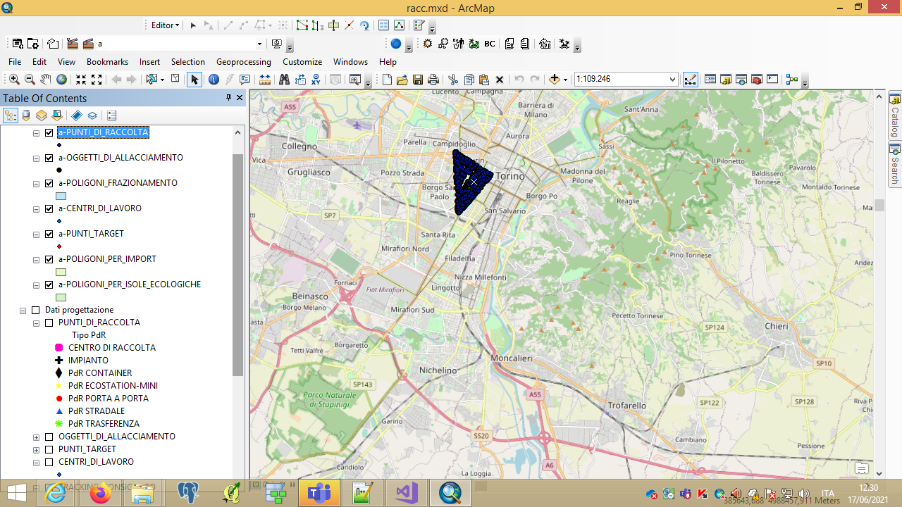

The problem is as follows:
in a rather random way the symbology is not correctly copied to the child layer. see example
(father: PUNTI_DI_RACCOLTA; child a-PUNTI_DI_RACCOLTA)
If we try to open the layer properties-symbology the CATEGORIES part is not there at all and even if the objects are there they are not displayed.
We did some tests on different machines to understand if it is a script problem or not and these are our results:
- on windows 2016 server machine and unpatched ArcMap the bug happens in 10% of the tests.
- on windows 8.1 pro machine and ArcMap patched (ArcGIS-1061-DT-FGSP-Patch, ArcGIS-1061-DT-GU-Patch) the bug happens in 90% of the tests.
This led us to think that it might be a bug.

I create a new GxFile with the .lyr, than create a Layer as a cast of the GxFile, than cast the Layer as a FeatureLayer and change the featureclass and the name.
How can I create a layer from an existing one?
