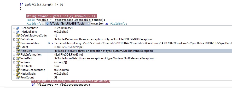

I would like to get the spatial reference of the feature class using file Geodtabase API.I am using FGDB API 1.4 and C# VS 2010. I have tried to use FieldDef to get Spatial Reference but receiving null error. Please guide me. Also attaching the error message.
string fcName = gdbFCList[2].Remove(0, 1);
                Table fcTable = _geodatabase.OpenTable(fcName);
                FieldInfo fieldInfo = fcTable.FieldInformation as FieldInfo;
FieldDef[] fieldDefs=fcTable.FieldDefs;
also tried following code
string spr = fcTable.FieldDefs[2].geometryDef.spatialReference.ToString();

The code throws null error when i try to cast FieldDef ( FieldDef[] fieldDefs =fcTable.FieldDefs;)
While debugging, the definition( FieldDefs, IndexDef)properties in the Esri:FileGDB:Table getting null values (Also tried with other C# samples provide with File Geodatabase API). Can any one tell me why it is throwing null value and can i  get Spatial Reference Details using File GeoDatabase API without using FieldDefs.
