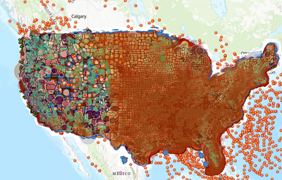

I made a map. Do you want to see it?
It's kind of pretty in a way, like a Jackson Pollock painting, and it's almost as informative. There's just too much stuff here. If only, I could group my data into logical categories that my end-users could easily turn on and off as they wanted. But that's just a dream...or is it? I don't actually know. I'm writing this as I go, but the February 2025 ArcGIS Online update should have made this dream come true. Let's find out together.

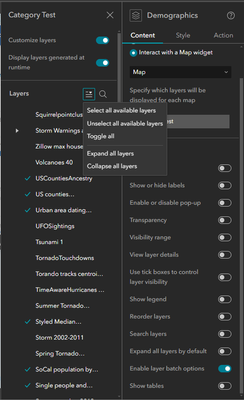

In Experience Builder, I am starting with the Pocket Template and I've added my webmap to the Map Widget. This Template has a big Placeholder Widget on the right side of the screen where I've added an Accordion Widget. If I was using a smaller number of categories, I would probably use a Section or Grid Widget instead, but somewhere around three or four an Accordion starts to make more sense.

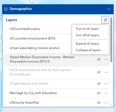

And into the Accordion, I'll add a Map Layers Widget. I'll rename this Widget to Demographics. Then, I'll Customize Layers. I'll use the handy new layer toggle to turn off all the layers at once. Then, I'll turn back on just the demographic related data. For the other options in this Widget the most important thing is: Enable Layer Batch Options.
Hey, before we go any farther, let's take a moment to test this out.
In Preview Mode, I click on the lines and triangle and Turn On All Layers...
...And after the February 2026 ArcGIS Online Update. It totally works. This feature should be available in Enterprise 12.1 and Developer Edition 1.20. It's not the best UI, but it works. If the Dev Team is listening, making Bookmarks that don't change the map extent would offer much better UI options. The rest of this post is staying unchanged for historical purposes.

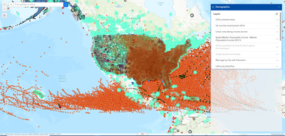

Oh, no. Pollock is back. Sorry folks, this isn't going to work. I really thought it would. I wouldn't have put so many layers into the map if I didn't think it would work.
Hey Dev Team, restrict the on/off all layers function to the Customized Layers within a Map Layers Widget and we would have something very great here.
