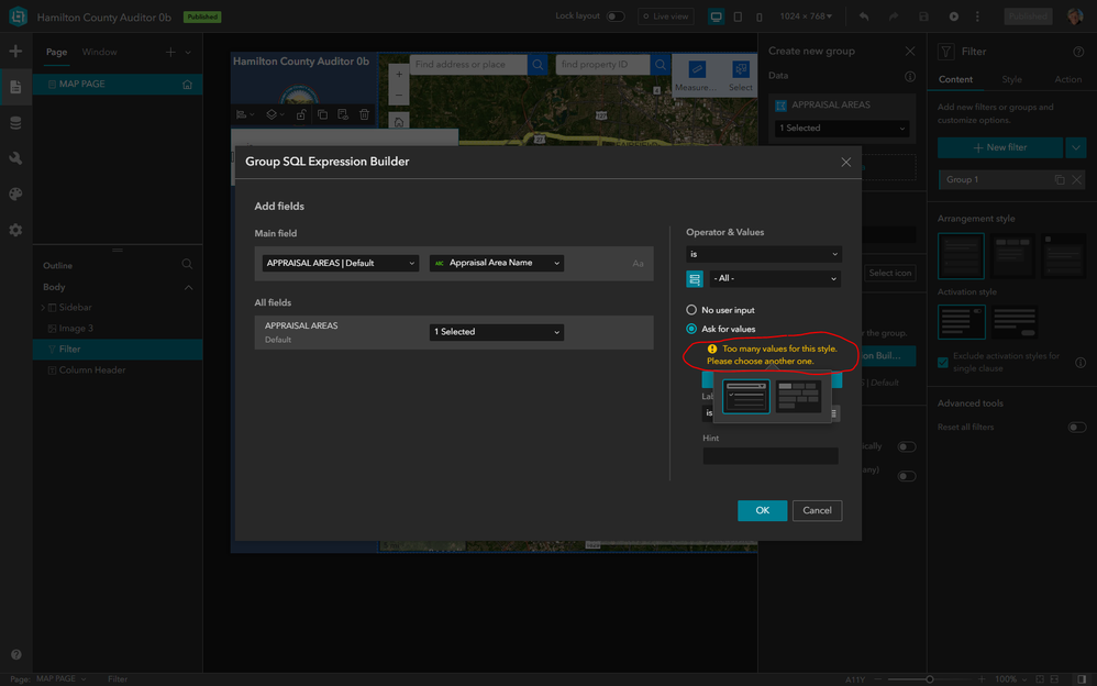

I've been tasked with developing a proof of concept, duplicating a desktop-based "property browser" which was delivered by a contractor some years ago.  With my other work being based in AGOL, initially I considered Web AppBuilder , Dashboards, and Instant Apps as the most direct development options.  However, ArcGIS Web AppBuilder will retire in the fourth quarter of 2025 and Experience Builder appears to be the replacement.
The central function of our "property browser", must be a "pick list" or category selector which drives the filtering of ~354,000 parcels in a polygon feature set.  This "pick list" or category selector must accommodate ~1,500 appraisal areas which are assigned to each parcel record.  Our "property browser" must allow the user to select which parcels are displayed, grouped by a single appraisal area, or by multiple appraisal areas.
I got this set up quickly in AGOL Dashboards, but I can’t do it fully in Experience Builder. This limit within Experience builder can be seen in the attached image.So what is the magic cut-off number?So what is the magic cut-off number?
I could use some help in navigating ESRI’s tech support world in order to determine:
1. Is the limitation with group filters in Experience Builder, as described above and unchangeable?
2. What are our other options, within ESRI, to have the functionality that we need in an application develop environment?

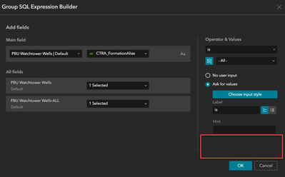

@JeffreyThompson2 Any ideas why I am not seeing the "List values based on" option when setting up a Group SQL Expression? I just updated to 1.16 Dev Edition but see the same behavior going back to 1.14. I must be missing something but can't seem to figure this one out
JeffreyThompson2
MVP Frequent Contributor
@JeremyDew Here are some things to keep in mind:
  1. The Select Source Type option must be set to Unique.
  2. You must have at least two separate Filter Widgets in your project.
  3. This option appears to only be available for certain data types. (just Text Fields, maybe?)
JeremyDew
Thanks @JeffreyThompson2. Seems to work when adding another filter widget. I had added another one previously but didn't think it was going to work since the "List values based on" option in the Group SQL Expression window.
AaronKoelker
@JeffreyThompson2 @JeremyDew I'm seeing the same issue Jeremy was, where the "List Values Based on" dropdown is missing from the Group filter options. But there must be another restriction out there in addition to what Jeffrey suggested, because I've got the source type set to "Unique", there are multiple filter widgets on the page, and I'm using a TEXT field across all layers. The option still doesn't show up, however, and I've run out of settings and configuration to check against. Anyone have any other ideas?
Edit: This was answered in a comment on another post. The dropdown was removed in later versions because it wasn't doing what the user might expect it to: Ability to filter multiple layers based on a common field
