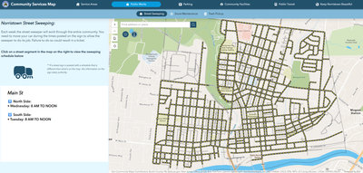

@CRP00 I have done something like this before where the header has separate pages (Menu widget in a Fixed Panel) and then in the "Public Works" page, you have a fixed panel (Views Navigation widget) with the 3 different subpages (Section widget)
Public Works | Community Services Map

@apgis16 this is really helpful, thank you. Love the layout as well and I think I'm going to explore this route. Have you experienced any loading issues with multiple pages at all? Subsequently, is each page able to have its own section widget with distinct views?
