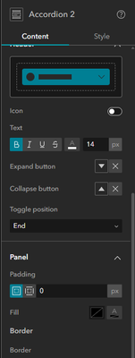

  5. To style my Accordion, I used the fourth Quick Style choice, then I changed up the Expand and Collapse Button (so they made more sense), set the Toggle Position to End, and set the Panel Padding to 0.JeffreyThompson2_0-1782153979596.png
