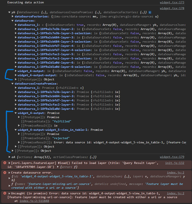

 I logged DataActionManager.getInstance() and got the table widget's ID.
When this method is executed, a new tab with the proper name is created in the table widget, but it is empty.
When logging DataSourceManager I see this widget's data source:
Along with the errors when the new tab is created.
How can I make this work? I would appreciate any kind of help. Please let me know if you need more info/context.
