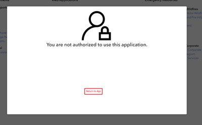

The rather silly solution I came up with was a widget that destroys the Experience if the wrong person looks at it. This widget will look at the user information in the ArcGIS Portal and if they are not in the authorized group, destroy the map and any tables in the Experience.
It initially loads with an oversized modal that blocks screen visibility. If the user is unauthorized, it will display an access denied message, while the data self-destructs behind it.
For authorized users, this model will close and the data will be unaffected. They will see their username as a subtle reminder that we know who you are.
To use this, change "Allowed Group" on line 40 to the name of the group in your ArcGIS Portal that can use this application. You may also want to alter the messages on line 73 and 84-93.

Thanks for this widget. I've played with it a little bit and think it has a lot of potential. If future iterations are planned, I would suggest including a button allowing users to return to safety or the home page of the app rather than freezing or crashing the app. User's can actually back arrow than refresh to continue using the app from the last page they're authorized to interact with but a button would simplify the process.
