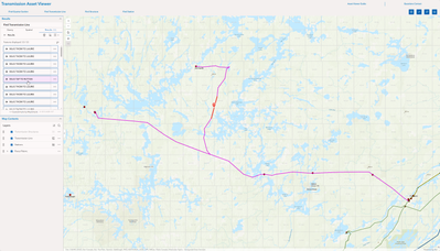

You can test this and the other new 1.20 features here:
https://exb-sample.mapsimple.org/
If you use the first QS widget, you will see the hover pin and the hover feature selection
If you use the other QS widget, the hover pin has been toggled off and you will only see the hover feature selection.
I added a new search in both widgets, streams. White river will get you multiple features returned so you can see how the highlight feature works a little better. I didn't have any public transit lines to add to the demo.

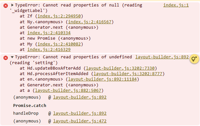

Hello @adamsimple , I'm trying to use your widget but nothing happens when I put the widget on the map but I have these messages on the console.
No errors are present when I start the both servers.Do you know what can I do ?
Thank you
adamsimple
Hi Karim, thanks for trying it out, and for the console output, which helps narrow it down.
Those errors are coming from Experience Builder's own layout-builder as it adds the widget, not from the widget's runtime code, which usually points to a version or install mismatch. A few things to check:
1. Experience Builder version. QuerySimple is built for ExB Developer Edition 1.20 (ArcGIS Maps SDK for JavaScript 5.0.4, React 19), and its manifest sets exbVersion to 1.20.0. On an older version (1.19 or earlier) the builder throws exactly these "_widgetLabel" / "setting" errors when you drop the widget. What ExB Developer Edition version are you running?
2. The shared-code folder. QuerySimple needs the shared-code/ folder copied into your-extensions/widgets alongside query-simple/ (and helper-simple/). If only query-simple/ was copied, it won't load. Can you confirm all three folders are present?
3. Rebuild and restart. After copying the folders, run npm run build from the client directory and restart the ExB server.
If your ExB is older than 1.20, that's almost certainly it, the current release is 1.20-only. There are older 1.19 releases on the Releases page if you need to match an earlier version.

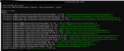

Below if my client terminal output. Yours should look similar. I crossed out items that are specific to other widgets that you won't have.

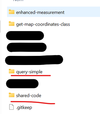

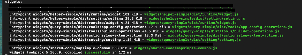

KARIMLABIDI
Thank you for your answer @adamsimple .I just want to try QuerySimple.
I 'm using 1.20 EXB DE.
So, this is my folders:
Here is the terminal output. Everything looks like ok but nothing still happens in the application and I still have the both messages I showed above.
